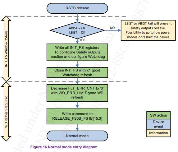

Hello, I want to ask whether the fail-safe output release function Sbc_fs26_FsxbRelease of the FS26 chip needs to be called in a loop

TomasVaverka
Hello Yazhou,
There is no need to call this function in a loop to release FSxB.
The below diagram provides high level flow chart to enter Normal mode in the application.
Tomas
