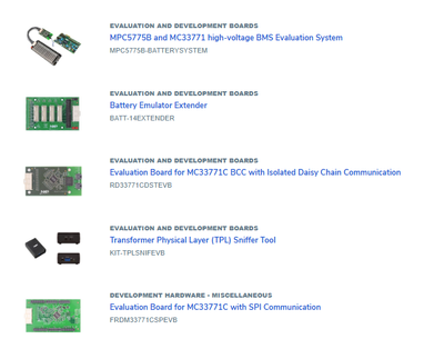

Regarding the charge and discharge control, unfortunately this is not tested and not recommended by NXP. Please refer to any MC3377xC evaluation board. No such a circuit is there. I believe this is the reason for the issue. Please follow the evaluation board schematics. These circuits were tested by NXP application engineers. You can take is as a reference.
https://www.nxp.com/products/power-management/battery-management/battery-cell-controllers/14-channel...
