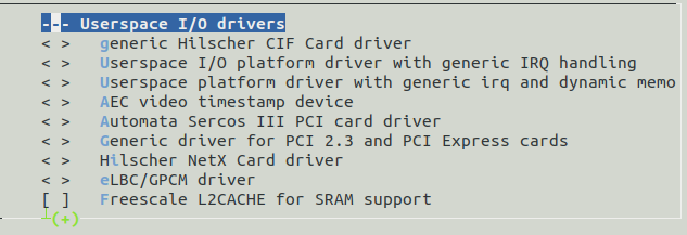

hello:
i want to run  rapidIO message unit application on p4080ds,but it work failed,the follow is the log:
root@p4080ds:~# rmu
rmu: fsl_rmu_unit_uio_init(): /dev/rmu-uio-msg0: No such file or directory
rmu: main(): rmu_unit_uio_init(): No such file or directory
i use the rcw bin file that serdes config is 0x16 from SDK2.0, i use uImage-p4080ds-usdpaa.dtb file,and i use “0b01001100” on SW3 (Serdes reference clock for bank1 is 125MHz, bank2 is 125MHz, bank3 is 125MHz).
but i can't find the item is linux menucofing:
Device Drivers --->
<*> Userspace I/O drivers --->
<*> Freescale Rapidio Message Unit support
my sdk2.0 source code is 20160527 version

ufedor
What do you see in the:
Device Drivers --->
Assuming that the SDK was not installed properly the latest SDK version can be downloaded from:

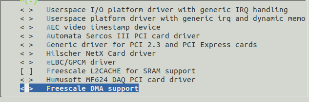

gaolixing
thanks for your reply
<*> Userspace I/O drivers ---> is the follow:
Screenshot from 2020-06-11 21-22-29.pngScreenshot from 2020-06-11 21-23-03.png
i use sdk2.0 20160527 version download from Linux® SDK for QorIQ® Processors | NXP ,because SDK2.0 version 2017.3 can't be compiled due to www.freescale.com is shut down
