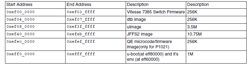

yipingwang
You could find the flash memory map from SDK document, please refer to the following NOR Flash memory map of P2020RDB-PC.
5,780 Views
mingqiangyin
Hi Wang
Thanks.I don't find this sheet in my document.I will save this picture of memory map you upload.
Yin
