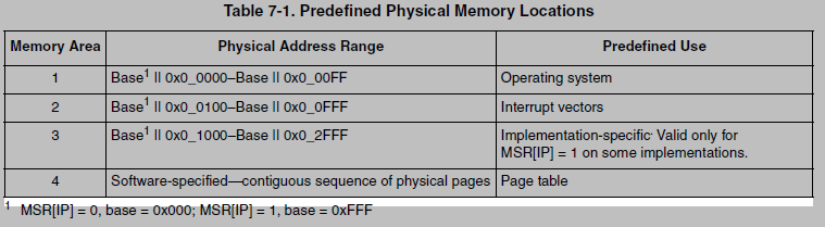

Now coming on to the actual document, section 5.3 in ePAPR talks of Initial Mapped Areas(IMA) areas which I believe are mapped by default to certain portions of the memory. Another reference to IMAs was found in the freescale powerpc programming environments manual section 7.3.1.1 called Predefined Physical Memory Locations . Do both these sections in these two documents refer to the same concept?
Here are the predefined physical memory locations
The freescale document says:
Four areas of the physical memory map have predefined uses. The first 256 bytes of physical memory (or if MSR[IP] = 1, the first 256 bytes of memory located at physical address 0xFFF0_0000) are assigned for arbitrary use by the operating system. The rest of that first page of physical memory defined by the vector base address (determined by MSR[IP]) is used for interrupt vectors or reserved for future interrupt vectors. So it means that when the process comes out of reset (which can be looked at as interrupt) it vectors into memory area 2 which can be either 0x0000_0100 or 0xFFF0_0100. Am I right here? If so, can this memory region be categorized as a Boot IMA as per the ePAPR document?
Now doing a quick scan of 0xFFF0_0000 under the arch/powerpc folder didn't quite turn up anything concrete:

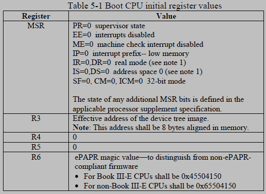

Secondly, I see in ePAPR in section 5.4 entitled CPU Entry points requirements that the initial register values must be as such:
However, when I see head_fsl_booke.S, I see the following comment:
/* As with the other PowerPC ports, it is expected that when code
* execution begins here, the following registers contain valid, yet
* optional, information:
*   r3 - Board info structure pointer (DRAM, frequency, MAC address, etc.)
*   r4 - Starting address of the init RAM disk
*   r5 - Ending address of the init RAM disk
*   r6 - Start of kernel command line string (e.g. "mem=128")
*   r7 - End of kernel command line string
Why is there such a discrepancy? The only thing common is the content of register r3. Since board info structure pointer and device tree image seem to be suggest the same thing. No?

Yes, ePAPR is a specification document, not documentation of particular software.  When it says "client program" that means the program, such as Linux, that is being booted via the ePAPR boot mechanism.  The software that does the loading, such as U-Boot, is the "boot program".  The hardware itself is not an ePAPR loader and thus the document is not relevant to how U-Boot starts.
Ignore the Programming Environments Manual.  That is for classic PPC chips such as mpc7xx or mpc83xx and it is not relevant to QorIQ.
Also ignore the comment in head_fsl_booke.S; that is describing the old way of booting that was used in arch/ppc, without a device tree.

The bootloader is still passing things in registers, but not the way head_fsl_booke.S describes.  It is described by ePAPR.  The most important one is r3, which points to the device tree.
