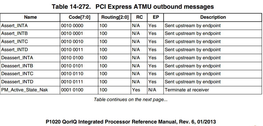

You wrote:
> *(unsigned int*)0xa0000000 = 0x20040000;
For the Assert_INTA message the operation should be:
*(unsigned int*)0xa0000000 = 0x8020;

ufedor
Message data[16-18] = Routing[2:0]
Message data[24-31] = Code[7:0]
INTA example:
Message data (big-endian, binary) = 0000_0000_0000_0000_1000_0000_0010_0000
> i send the message 0x8020,   but the result is the same......
Check settings of the P2041 MPIC.
What are values of the GCR, CTPR0 and corresponding EIVPRn?
Which PCIe controller of the P2041 is used?

ufedor
> Reg[eivpr0]=0x80c0_0000;
This means that MSK=1 and PRIORITY=0.
Possible correct value can be 0x00410000.
Concerning the EIVPR0[P] value :
Note that it is possible to share IRQn and INTx if the external interrupt is level sensitive;
however, if an interrupt occurs, the interrupt service routine must poll both the external
sources connected to the IRQn input and the PCI Express INTx sources to determine
from which path the external interrupt came. In any case, IRQn should be pulled to the
negated state as determined by the associated polarity setting in EIVPRn[P].
