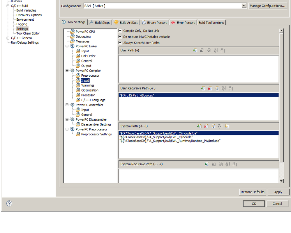

marius_grigoras
You should include the folder with your headers in User Recursive Path (take a look in the below picture) from -> right click on your project -> Properties -> C/C++ build -> PowerPC Compiler -> Input -> User recursive path

pierre-antoinem
I still have the same errors.
I have a directory where all my .c .h .asm files are included in user path.
Is it possible to set the equivalent default P5020's compiler (PowerPC AEABI e5500 C Compiler) to the P2020 ?
