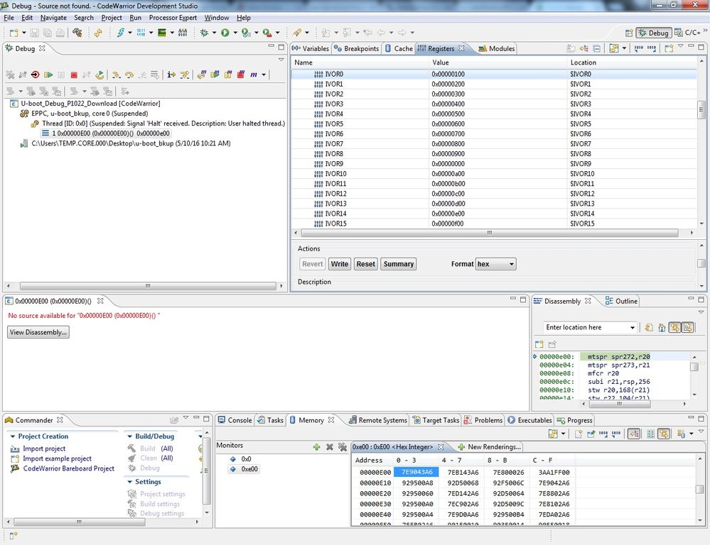

By running codewarrior in attach mode,we are getting PC value as 0xe00.

santoshkumaraki
Hi Adeel,
Thanks for your replay...
Full address is 0x00000E00.
It is mapped to IVOR14 - instruction TLB error interrupt vector.
Santosh Kumar

santoshkumaraki
We have tried with default uImage with load address as 0x0 and observed prints are coming up to "Uncompressing Kernel Image ..."(OK print is not coming) and getting hanged.
We have observed u-boot is writing some interrupt vectors from 0x100 to 0xf00 locations.
After changing load address to 0x20000000 using mkimage uncompressing is working fine.
We are not sure whether this vectors causing issue or not...
Please find the screenshot for the interrupt vector address(IVOR) in codewarrior register list..
