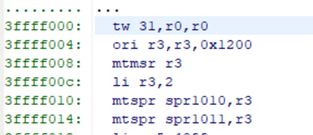

  • The instructions for assembly function StartSecondaryCpu was successfully copied to the BootPageAddress

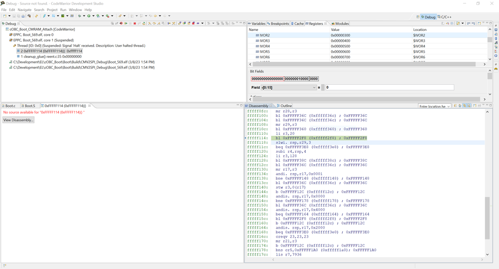

When attaching to Core 1 and pausing, we see that it is stuck at instructions at 0xFFFFF114, from cleanup_glue() reent.c35 0x00000000, see attached image. This address 0xFFFFF114 is part of the default boot ROM which we do not want to exectue from. Core 1 should be stuck in an infinite loop as part of the StartSecondaryCpu assembly function but it is not. While core 1 is paused with the debugger the following was observed:
  • Reading the memory for the core 1 stack pointer showed it had been initialized.
  • Looking at the TLB entry registers showed that it was setup as intended.
  • IVPR, IVOR registers updated correctly
Thus seemingly the setup code for core 1, in StartSecondaryCpu assembly function, is being run.

After some debugging we have realized that the second core is now up and running.
We still cannot see what we had expected to see in the debugger, to us it still looks like core 1 is executing at 0xFFFFxxxx and that the code shown by the debugger at those addresses is not the code for our __secondary_spu function as described by my colleague earlier in this conversation.
However, by letting core 1 read-modify-write the value at an address in RAM while executing in the final eternal loop and continuously read that same address from core 0, we can see that the value is incremented.
This enough for us to continue our work. Thank you very much for your help.

What we see is that when we attach to core 1 it halts on 0xFFFFFFFC. Thus, we are unable to step through the code for  "__secondary_cpu" to see where it goes wrong.

Checking memory 0x3FFFF000 we see the code that was copied from __secondary_cpu.
However, checking 0xfffff000 from core 1 view in the debugger show what looks like the on-chip boot and not our __secondary_cpu.
Do we expect them to be the same?  As stated in previous message, we are unsure of how to set up the debugger in this case.
As for the caches we have them disabled during boot.

yipingwang
Please refer to the update from the AE team.
Q: Do we expect them to be the same? As stated in previous message, we are unsure of how to set up the debugger in this case.
Yes. After enabled the boot page translation, the boot page space is mapping to the address that configured in BPTR. So they should be same.
If you not sure you get the correct state via codewarrior, I think you can configure the BPTR and access the boot page space from core0. If you cannot get he expected content in boot page space from core0, I think core1 cannot execute the instruction from the same address.
