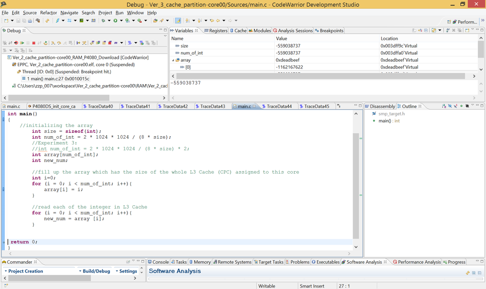

I am currently doing an project which requires to partition the CPC of P4080DS by configuring its Partitioning Control Registers in the initialization script from CodeWarrior.
I have created 8 more LAWs, which are LAW10 to LAW 17, each with  the size of 256MB. And I have configured 8 sets of CPC ID register, CPC  way register and CPC allocation register, with PID from 1 to 8, matching  with LAW10 to LAW17. For each coherency subdomain, I allocate 4  CPC ways to it. Attached is my modified initialization script.
After I modified the configuration. I found that it is working, the program on Core 0 will automatically write to LAW10, and hence write to CPC  way 0 to 3. Similarly, the program on Core 1 will automatically write to  LAW11 and hence write to CPC ways 4 to 7. The same situation applies  for all 8 cores.
But I found three weird things, which I am not sure where I did wrong:
(1) When I run the program, the value of variables and their locations in Variables pane are not correct, quite strange. As shown here.

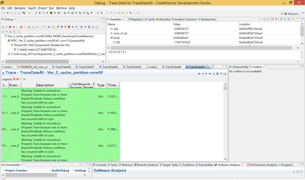

(2) The trace is not working as below.
21414_21414.pngerror1-2.PNG.png.
(3) The profile tool cannot get results.
