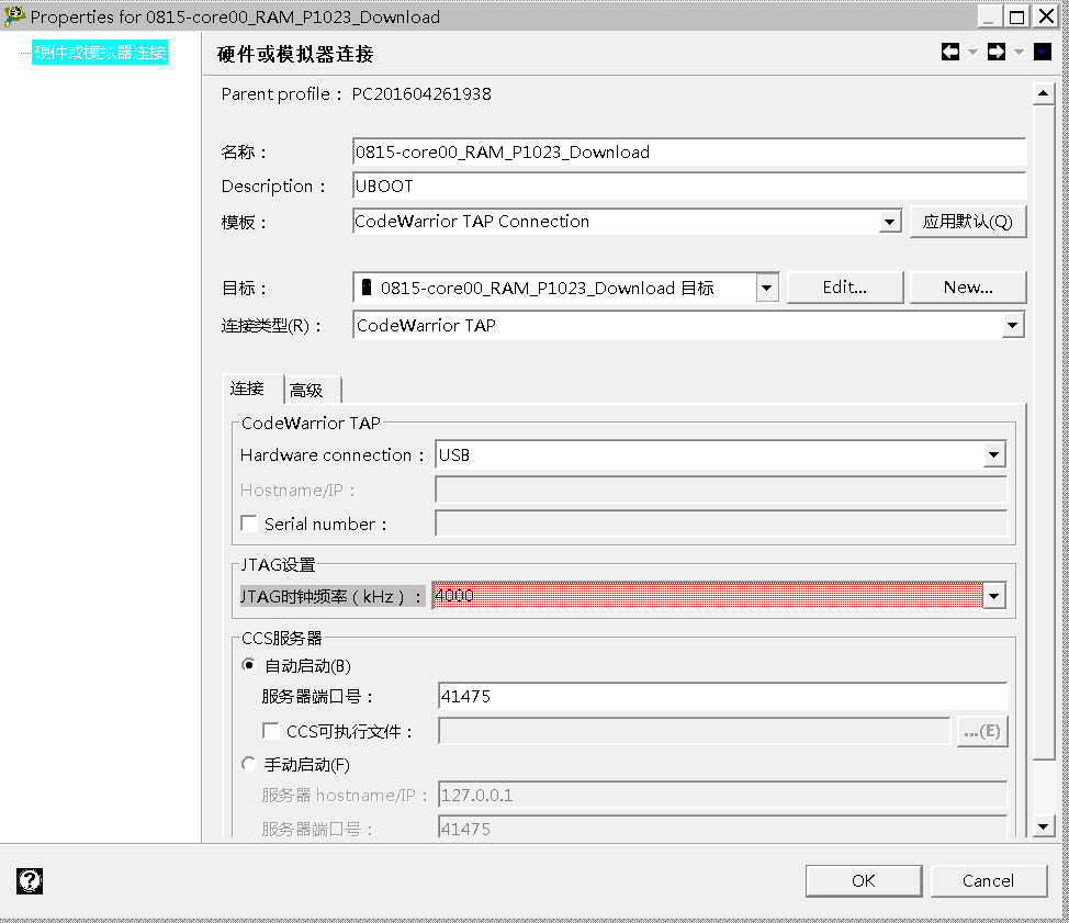

hello, I just want use CW10.5.1 ev and Codewarrior  TAP(over USB) for write bootloader to P1023 norflash,S29GL512P,my connection configuration like below:

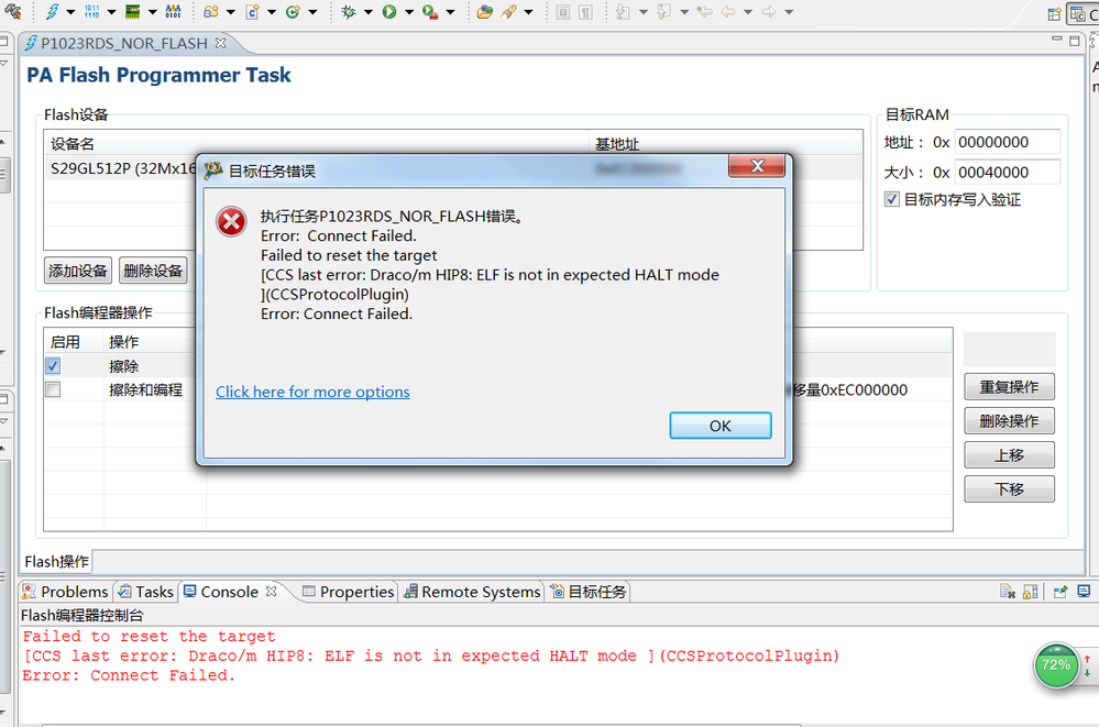

pastedImage_1.pngbut when I erase flash there is always say ,Connection failed,ccs config string is invalid,like the pictrue:pastedImage_2.pnganyone can help me ??

Check connection to CodeWarrior TAP using CodeWarrior TAP User Guide:
http://www.nxp.com/files/soft_dev_tools/doc/user_guide/CWTAPUG.pdf?fasp=1&WT_TYPE=Users%20Guides&WT_...
Is there CodeWarrior TAP in Device Manager? See attached screenshot.
Is there connection to CodeWarrior TAP configuration console? See the Section 2.2.

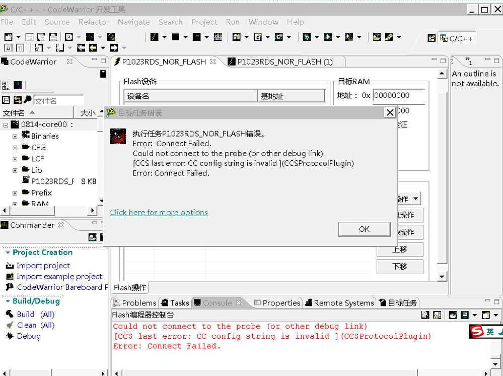

thank your apply!! I think I got little progress ,but I programmer flash there is still a wrong like below,any suggestions?
