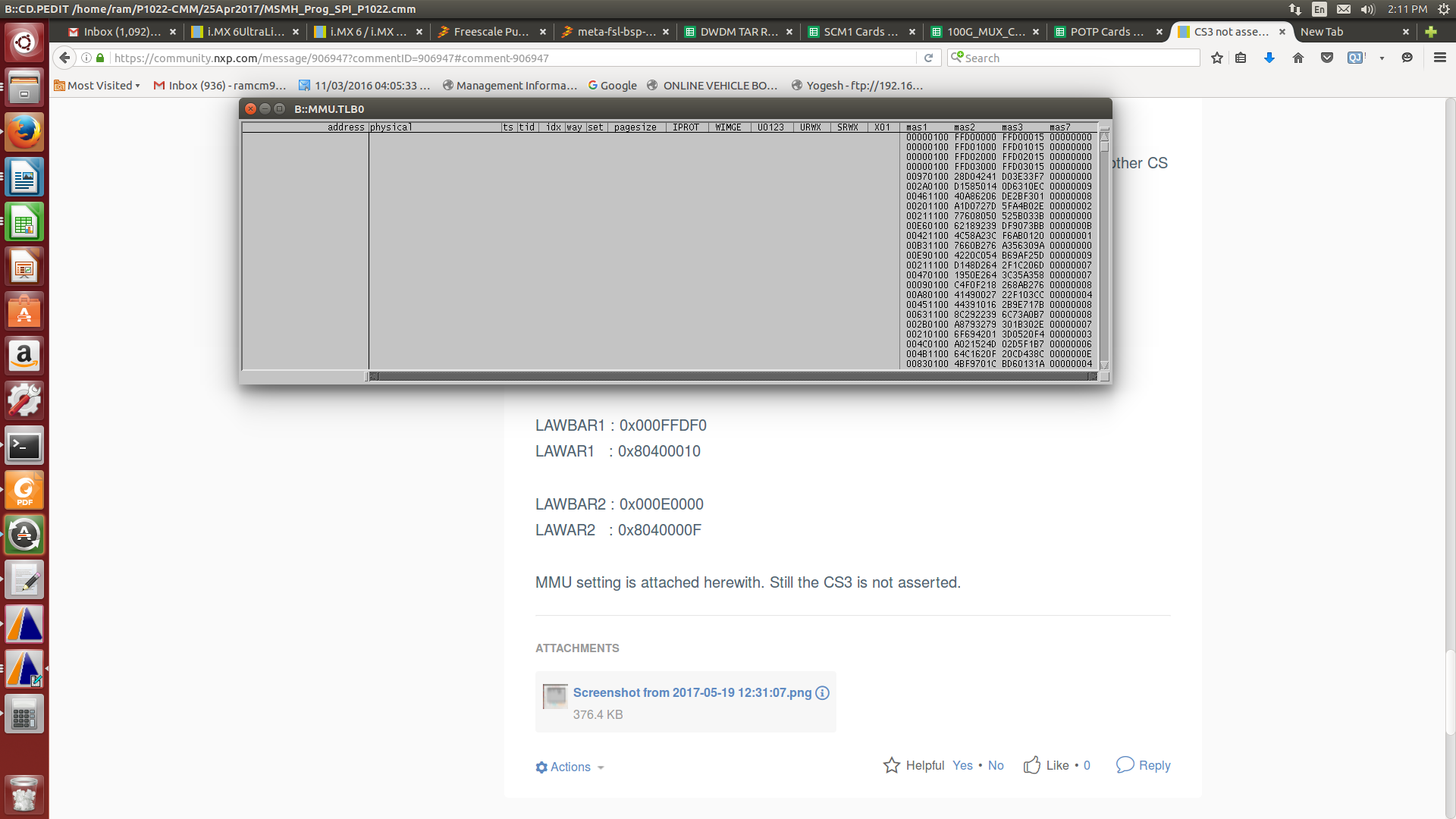

   I have relocated the CS3 configuration to different address space and excluding all other CS configuration. Now I have only CS3 configuration. The target is booting up correctly irrespective of CS2 configuration as opposed to the case observed earlier.
BR3 : 0xE0008801
OR3 : 0xFFFF8FF7
LAWBAR0 : 0x000E8000
LAWAR0   : 0x8040001B
LAWBAR1 : 0x000FFDF0
LAWAR1   : 0x80400010
LAWBAR2 : 0x000E0000
LAWAR2   : 0x8040000F
MMU setting is attached herewith. Still the CS3 is not asserted.

rammurmu
PFA tlb0 settings.
