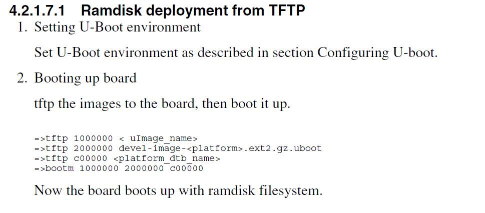

Then, to transfer it you have some options. Is anything running on the target board? Since it's a QDS, I imaging U-boot comes up. The easiest way to use your compiled image is to TFTP them from the desktop x86 server to your T4240 target. To do this you need a TFTP server running on your desktop PC. Here's a link to set it up under Ubuntu:
How do I install and run a TFTP server? - Ask Ubuntu
The SDK binaries are located within the SDK directories. In your case it should be under /../build_T4240_release/tmp/deploy/images/
There should be a bunch of files in there:
     u-boot[...].bin (this is the SDK's version of U-boot)
     uImage[...].bin (this is the linux kernel)
    uImage[..].dtb (this is the device tree which describes the board)
     fsl-image-[full/core/etc...].tar.gz  (this is the root file system)
    fsl_fman_ucode[..].bin (this is microcode to run on the FMAN)

There are a couple of ways to deploy a new linux: NFS (which may be complicated to set up on your hose) and ramdisk (running out of ram on the target) are the most common. I would recommend starting with ramdisk.
On the desktop you would have to copy the binary over to your /tftpboot directory. Then from the u-boot on the target you need to transfer it over, section 4.2.1.7.1 in the SDK 1.5 document goes through this procuedure.
