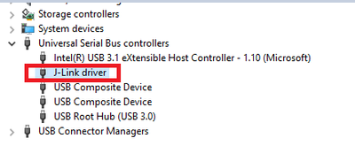

Hi @yvzblgcyln :
please check the device manager of your pc, there should have a J-link driver.
If this J-link driver exists, please use jlink commands to check this connection is successful, please refer to  below picture.
4,403件の閲覧回数
yvzblgcyln
Hi, there is a J-link driver in device manager as you sent. Then i checked my connection, at the end of process J-Link commender said "Cannot connect to target". What am i suppose to do?
