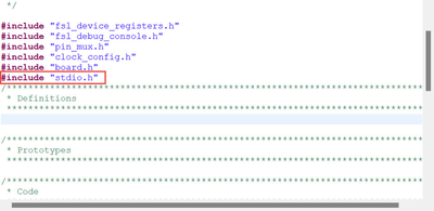

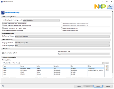

When you create a project, you need to set Redlib: Use floating point version of printf, as shown below:
1. Add #include "stdio.h":
2. Set macro definition SDK_DEBUGCONSOLE_UART=1, right-click project -> Open the properties window and refer to the following image:
3.Use the printf () function to print normally.
