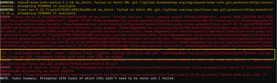

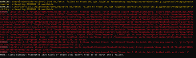

I tried to build Linux for imx6ull14x14evk with fsl-imx-wayland distro of Ubuntu 20.04 (WSL2) which I already allocated 16GB of RAM and 4 cores processor. after running: bitbake imx-image-core, the kernel fetch process seems working fine.
but after 30%, the error occurs, and it starts to fetch from the mirror source but not successfully.
How can I solve this problem? If possible, step to perform manual download is also appreciated.

 After observing the error message: I found out that the build system expected the file name: github.com.nxp-imx.linux.git. So I do as follow:
1. git clone -b lf-5.15.y https://github.com/nxp-imx/linux-imx.git  to any dir is ok
2. copy the clone dir to download-dir/git2 by change the name to github.com.nxp-imx.linux.git
3. create. done by touch github.com.nxp-imx.linux.git. done
4. run bitbake -c cleanall
5. run bitbake imx-core-image
Now it working.
But one thing I notice from error message, seem the build recipe have the error on the path when perform the mirror do_fetch because download path on my machine is : /home/megamama/imx-yocto-bsp/downloads/git2/ but it use /home/megamama/imx-yocto-bsp/downloads//git2/ (double //)

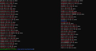

But I am still new to Yocto and I have some questions related to manually configuring the kernel.
1. If I do git clone, do I need to checkout to a specific branch If-5.15.y?
2. As I check in the download directory, I see all fetch files are compression with ext . tar.gz. Do I need to compress my kernel file after clone?
3. If I need to compress, what name should I give to this compress file?, so yocto build system can find it
7,152 Views
