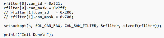

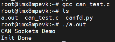

This is the C-program configurations :
socket(PF_CAN, SOCK_RAW , CAN_RAW);
setsockopt(sock, SOL_CAN_RAW, CAN_RAW_FD_FRAMES, &enable_canfd, sizeof(enable_canfd));
setsockopt is giving me error code 22 (EINVAL).

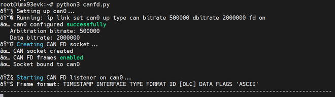

Unable to attach the python script so i am pasting it:
#!/usr/bin/env python3
CAN FD Listener Script for i.MX8
Opens socket and listens for CAN FD frames on can0

    def create_socket(self):
        """Create and configure CAN FD socket - like your create_canfd_socket()"""
        print(f"🔌 Creating CAN FD socket...")
        try:
            # Create CAN socket
            self.socket = socket.socket(socket.PF_CAN, socket.SOCK_RAW, socket.CAN_RAW)
            print("✅ CAN socket created")
            # Enable CAN FD frames
            self.socket.setsockopt(SOL_CAN_RAW, CAN_RAW_FD_FRAMES, 1)
            print("✅ CAN FD frames enabled")
            # Bind to interface
            self.socket.bind((self.interface,))
            print(f"✅ Socket bound to {self.interface}")
            return True

Hi @abhayaugustin1
CAN FD is supported in imx8mp can driver,  but I have difficulty  to test this feature with 8MP EVK board.
Now I am using imx93 EVK to test this feature, since i.mx93 and i.mx8mp share the same driver.  The python script works for i.MX93 EVK.   Do you have C script for CAN FD ?
163 次查看
danielchen
Hi @abhayaugustin1
I tried  the setsockopt  function (C-program) on i.MX 8MP evk in my side, CAN FD socket configuration succeeds without errors.
