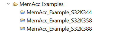

Hi @Anitha7,
FEE is not required for MemAcc to work with PFlash.
You can use MemAcc + Mem_INFLS directly for PFlash operations.
There are some MemAcc RTD examples.

Hi @Anitha7,
