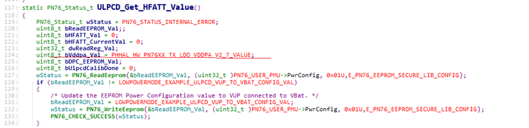

danielchen
I can see the VDDPA in several files. For example,  in file  nfc_low_power_mode\ lpm.c
