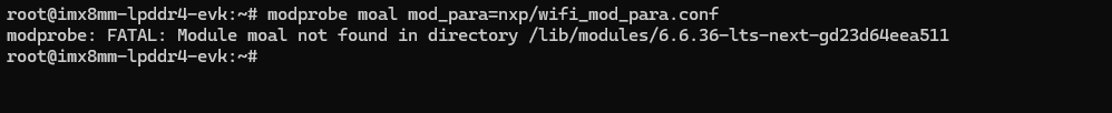

I am currently working with the i.MX8M Mini LPDDR4 EVK module and have built a Yocto image (imx-image-multimedia). The kernel version for my Yocto Linux build is 6.6.36-lts-next-gd23d64eea511.
After successfully building the image, I attempted to enable WiFi and Bluetooth functionality by referring to the i.MX Linux User's Guide (connectivity section).
However, when I tried running the modprobe command, it resulted in an error.
Upon further debugging, I identified that I needed to build the necessary WiFi drivers within my Yocto environment.

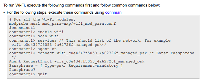

I referred to the UM11675 manual, which outlines the process for downloading and building NXP WiFi drivers. How to Download and Build NXP Wi-Fi Drivers - User manual (restricted)

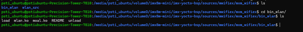

Following the steps provided in the manual, I downloaded the mwifiex and imx-firmware repositories and completed the process of building the drivers
after that I followed the steps
At the end of the process, the bin_wlan folder was successfully created, and I was able to locate the mlan.ko and moal.ko files.
Note: I followed all the steps, and all steps were executed successfully.
To integrate these drivers, I added the nxp-wlan-sdk to my local.conf file as shown below:
After this, I rebuilt the Yocto image using the following command:
# bitbake imx-image-multimedia
The build completed successfully and image deployed to the iMX8M Mini lpddr4 evk, but I am still encountering the same issue with WiFi and Bluetooth functionality.
Could you kindly guide me on whether I am on the right track or if additional steps are required? Your support in configuring WiFi and Bluetooth for the i.MX8M Mini EVK would be greatly appreciated.

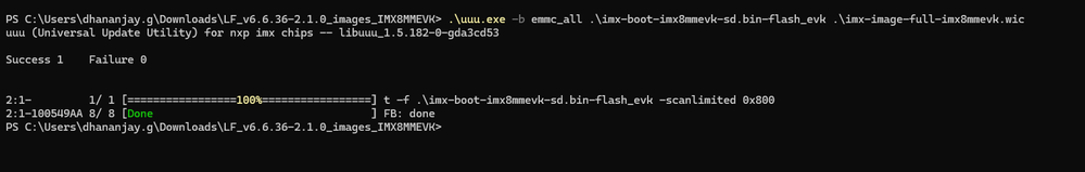

Could you run the following test for me?
1. Download the LF6.6.36 prebuilt binaries accepting the terms in the following link.
2. Flash an SD with the full image and try to run the steps from the chapter 11.1 Connectivity for Bluetooth wireless technology and Wi-Fi.
uuu -b sd_all imx-boot-imx8mm-lpddr4-evk-sd.bin-flash_evk imx-image-full-imx8mmevk.tar.zst

I have downloaded the prebuild binary LF6.6.36 by using the provided link. However, when I tried to flash the image using the given command:
The flashing process completed without any errors, but I was unable to boot the board successfully.
I attempted to boot from both the SD card and eMMC storage.

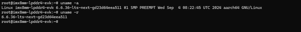

[    0.000000] Booting Linux on physical CPU 0x0000000000 [0x410fd034]
[    0.000000] Linux version 6.6.36-lts-next-gd23d64eea511 (oe-user@oe-host) (aarch64-poky-linux-gcc (GCC) 13.3.0, GNU ld (GNU Binutils) 2.42.0.20240716) #1 SMP PREEMPT Wed Sep  4 08:22:45 UTC 2024
[    0.000000] KASLR enabled
[    0.000000] Machine model: FSL i.MX8MM EVK board

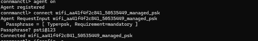

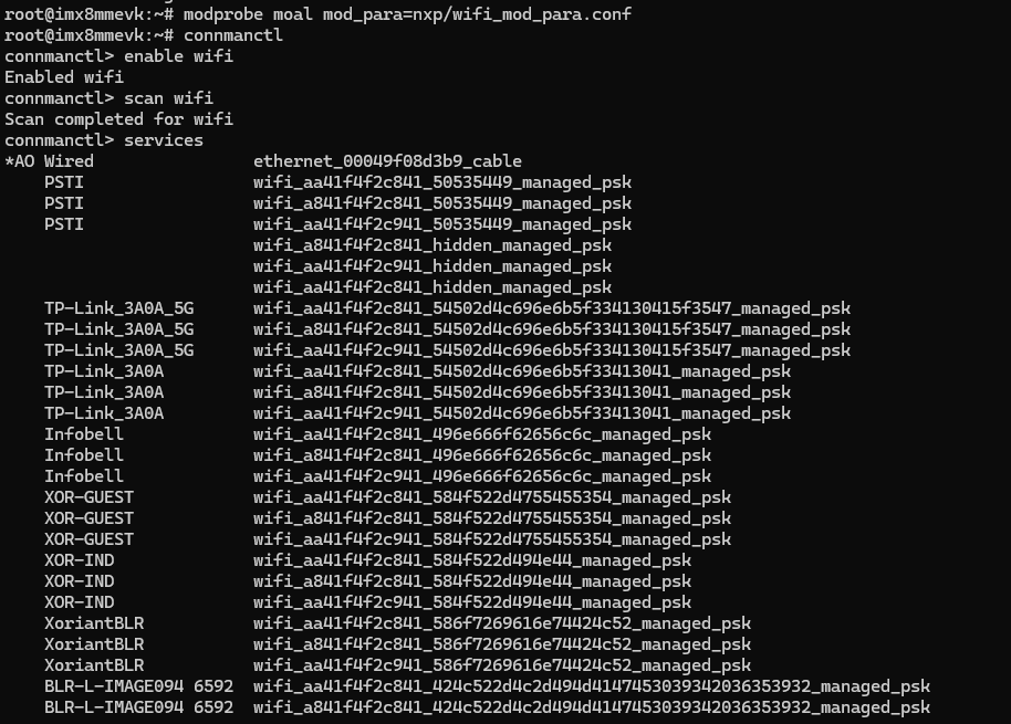

After logging into the device, I followed the steps mentioned in the Connectivity section as suggested.
After this I was successfully able to connect to Wi-Fi.
After this I tried to configure Bluetooth.
I was successfully able to scan nearby devices.
