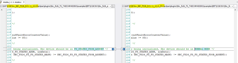

Hello all,
I'm confused with an example about FS26 and S32K344.
I'm checking Sbc_fs26_TS_T40D34M40I0R0, and in a moment there is this check:
    /* Read data in SBC_FS26_FS_STATES register - after being initialized, Sbc device should be in FS_STATES_FS0B_ASSERT */
    eReturnValue |= Sbc_fs26_ReadRegister(TRUE, SBC_FS26_FS_STATES_ADDR, &rxData);
    if((eReturnValue != E_OK) || ((rxData.u16ReadData & SBC_FS26_FS_FS_STATES_MASK) != SBC_FS26_FS_FS_STATES_FS0B_ASSERT))
        bPass = FALSE; /* Error during initialization. */
Looking the comment, it is checking if FS26 is in normal mode, but in the IF condition we can see that it is testing with SBC_FS26_FS_FS_STATES_FS0B_ASSERT macro. Since it is checking if it is in normal mode, shouldn't it be
SBC_FS26_FS_FS_STATES_NORMAL_FS?

The example that I'm saying is:
Sbc_fs26_example_HLD_S32K344:
    /* Read data in SBC_FS26_FS_STATES register - after being initialized, Sbc device should be in NORMAL MODE */

But if you take a look the examples into the project, there is this comment in the main.c:
But it is checking with SBC_FS26_FS_FS_STATES_FS0B_ASSERT and not SBC_FS26_FS_FS_STATES_NORMAL_FS:
Two questions:
1- What this option "Release Safety Output" means for normal mode? I didn't understand why you commented this option.
2- Do you have any document with instructions about how to configure the SBC using Tresos?

quangvuanh
I would like to clarify code comments in the example. The package you are using is 4.0.0_P01 and yes, the comment was wrong, and it was fixed in our latest released package 4.0.0ex_compare.PNG
About your questions:
1. The device is in Normal operation with all regulators being enabled, but the difference between FS_STATES_FS0B_ASSERT and FS_STATES_NORMAL_FS is on the logic level of FS0b pin. Note that these present the FS State Machine but not the operating mode of the device (operating modes are: Normal, Standby and LPOFF)
the option I showed above allows you to release this safety pin during execution of Sbc_fs26_InitDevice() function. In the example, it was set to NONE, then the expected FS State machine is FS_STATES_FS0B_ASSERT.
2. The best reference is in the driver user manual, you have it inside the package. Please refer chapter 4. Tresos Confguration Plug-in for more detail.
Dont hesitate to ask me more if you are not clear with my explanation
BR,
QuangVA
