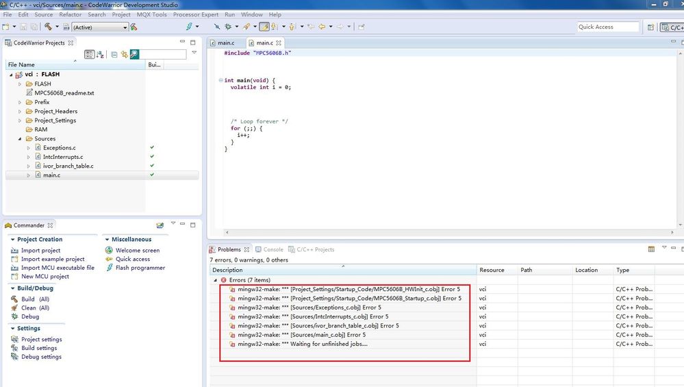

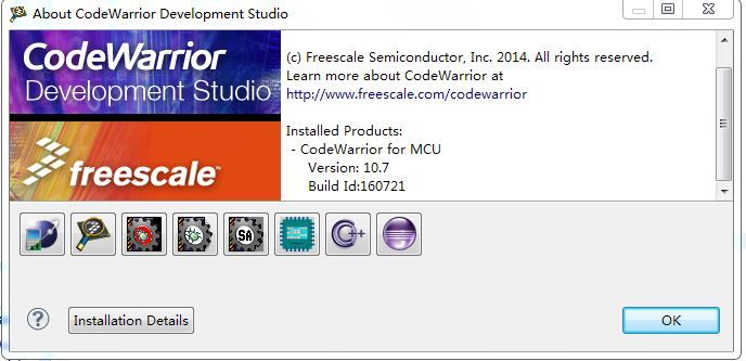

hi:

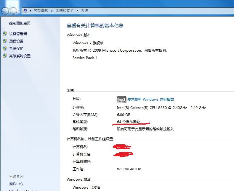

  I install the CodeWarrior software on my computer.  After installation,I create an MCU bareboard Project. Then I bulid,but I find the errors(mingw32-make[...]Error 5).I can't find the solution.My computer is a 64 bit operating system. See the following picture for details.
thank you

I just created a MPC5606B project with CW10.7, no issue. See attached video. Could you please try the same steps on your side as well?
Your problem is not related with windows. CW10.7 can support 64bit win7.
I suggest you use the latest  CW11.1 instead. Create a NEW workspace and NEW project to test it again.
https://www.nxp.com/design/software/development-software/codewarrior-development-tools/codewarrior-l...
Have a nice day

Hi Zhang:
Thank you for your reply .
 I suspect that the version of CW which I am using now is CW11.1.   Can you help me take a look?
My Download link:
https://www.nxp.com.cn/design/software/development-software/codewarrior-development-tools/codewarrio...
 And the question "mingw32-make Error5" was solved  (solution: Run CW software as an administrator )
thank you
