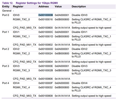

My configuration: 1GBit, RGMII. I have used the script(s) which I attached for static configuration. (I have tried many different configuration scripts to be sure the problem is not caused by my config file)
Then I also configured the Clock Generation Unit (CGU) and Auxiliary configuration Unit (ACU) as following:
So, the ACU and CGU is also valid! Then, I connected the devices on ports and start testing.

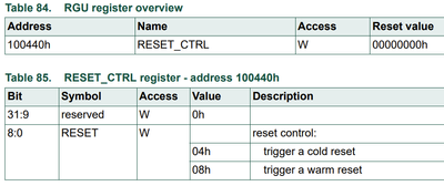

I resolved that problem. It caused by the missing reset in beginning. Before the uploading static config I have called the "Reset Generation Unit (RGU)"  RGU register with cold reset mode and my problem is resolved.
