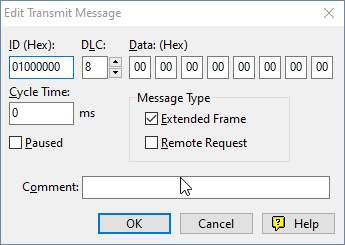

Could you anyone help to check what's the problem with the SJA1000 CAN controller? Thanks in advanced.
It reports RX error when received a message from PCAN-View, here is my test logs:
test: 0xab (test register read back OK)
set mode to 0x01
mode: 33
---- read back configs ----
mode: 9
BTR0: 0x80 (bitrate 1M/s at 24M CLK)
BTR1: 0x36
ACR: 255 255 255 255
AMR: 255 255 255 255
OCR: 26
mode after started: 8
status: 12
CANDRV started!
status: 12, mode: 8, ECC: 0, RXERR: 0
status: 92, mode: 8, ECC: 167, RXERR: 135
ECC: 167 means "stuff error", "ID.17 to ID.13"
And here is the message sent with PCAN-View:
By the way, the controller cannot send any message out also, and there's no 120 oms resistor between CAN-H and CAN-L.

Sightrix
If the 120ohms resistor is MUST?
8,103 Views
Sightrix
YES! Everything is okay after the resistor added.
