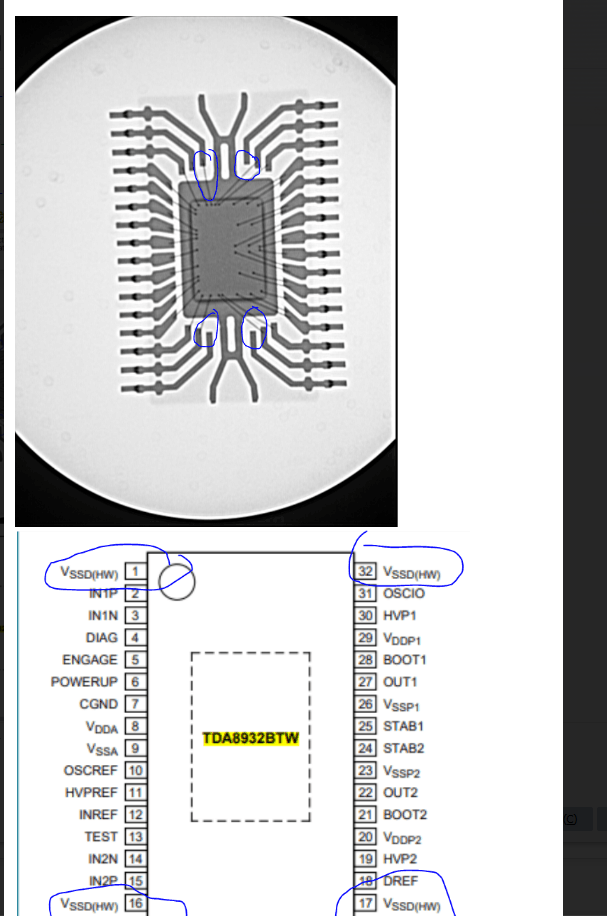

Part:TDA8932BTW/N2,118 ,Is it normal that pins 1, 16, 17 and 32 are not connected by X-ray? Please help to give an explanation, thanks!TDA8932BTWN2,118.png

Are these 1, 16, 17 and 32pins  electric connected together when you test this part?

Only 1 pin is connected, 16,17,32 are not connected

Please see X-RAY picture attached.
