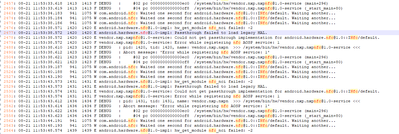

The logcat log message is as follows:
08-21 11:53:35.184 941 1075 W com.android.nfc: Waited one second for [email protected]::INfc/default. Waiting another...
08-21 11:53:38.186 941 1075 W com.android.nfc: Waited one second for [email protected]::INfc/default. Waiting another...
08-21 11:53:38.571 1420 1420 E [email protected]: hw_get_module nfc_nci failed: -2
08-21 11:53:38.572 1420 1420 E [email protected]: Passthrough failed to load legacy HAL.
08-21 11:53:38.572 1420 1420 E [email protected]: Could not get passthrough implementation for [email protected]::INfc/default.
08-21 11:53:38.572 1420 1420 F [email protected]: Error while registering nfc AOSP service: 1

chaoxiandandan
日志如下

chaoxiandandan
There are two logs as follows
dmesg_202408281442.txt
logcat_202408281442.txt
