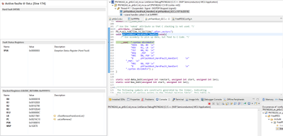

I'm using PN7462AU_ex_phExCcid sample from 'PN7462AU FW and SW Examples Full Version - v06.10.00' with 'OM27462CDKP: NFC Controller development kit'.
I'm trying to add an array like this 'uint8_t tempBuffer[600]' as a global variable in 'phExCcid.c' file.
Than just for testing purposes i change item of an array like this 'tempBuffer[400] = 0x2' in 'int main(void)' in  'phExCcid.c' file.
OR
I tried to access that array from one of RTOS task.
After these changes sometimes firmware ends up in "phFlashBoot_HardFault_Handler" sometimes it just freezes.
If I try to increase stack sizes of RTOS tasks i'm getting "vApplicationMallocFailedHook".
I tried to change "Heap & Stack placement" and their sizes in MCU Linker-> Managed Linker Script settings but i didn't get any result.
I've been dealing with this problem for days without any result. I already read datasheet and documents given with the product. I think the change that needs to be made is quite simple, but I couldn't find it.

Please be aware that for PN7462 , the user SRAM is limited to 12000 bytes and 256 bytes is used by NXP FW executed in ROM.    Heap , stack and BSS and some reserved RAM need to be stored in this area. see below picture.
if you add an array like this 'uint8_t tempBuffer[600]' as a global variable in 'phExCcid.c' file. this will add more 738 bytes (I tested on my side) in BSS.  it means the size of heap and stack will be reduced by 738 bytes.  why do you need so large array in this memory constrained device?
If the size of heap and stack reduced by 738 bytes, there there will be a conflict issue of heap and stack. will result in system crash.
You can try to build the release version,  it can work without issues if you add the large array.
To avoid the conflict, one option you can try is to reduce the stack size of  other tasks.
For example , I reduced the clif task size by 100 bytes, there will be no errors on my side,  You need to do more test .
change the cli stack size in phExCcid_Cfg.h
line 62
from
#define PH_EXCCID_CFG_RTOS_CLIF_TASK_STACK_SIZE    (440 + PH_EXCCID_CFG_RTOS_STACK_GUARD + PH_EXCCID_CFG_CLIF_LOG_STACK)
to
#define PH_EXCCID_CFG_RTOS_CLIF_TASK_STACK_SIZE    (340 + PH_EXCCID_CFG_RTOS_STACK_GUARD + PH_EXCCID_CFG_CLIF_LOG_STACK)
I hope it helps
