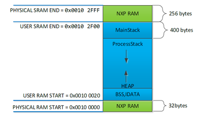

danielchen
Hi   @EE_Ark
Please be aware that for PN7462 , the user SRAM is limited to 12000 bytes and 256 bytes is used by NXP FW executed in ROM.    Heap , stack and BSS and some reserved RAM need to be stored in this area. see below picture.
if you add an array like this 'uint8_t tempBuffer[600]' as a global variable in 'phExCcid.c' file. this will add more 738 bytes (I tested on my side) in BSS.  it means the size of heap and stack will be reduced by 738 bytes.  why do you need so large array in this memory constrained device?
If the size of heap and stack reduced by 738 bytes, there there will be a conflict issue of heap and stack. will result in system crash.
You can try to build the release version,  it can work without issues if you add the large array.
To avoid the conflict, one option you can try is to reduce the stack size of  other tasks.
For example , I reduced the clif task size by 100 bytes, there will be no errors on my side,  You need to do more test .
change the cli stack size in phExCcid_Cfg.h
line 62
from
#define PH_EXCCID_CFG_RTOS_CLIF_TASK_STACK_SIZE    (440 + PH_EXCCID_CFG_RTOS_STACK_GUARD + PH_EXCCID_CFG_CLIF_LOG_STACK)
to
#define PH_EXCCID_CFG_RTOS_CLIF_TASK_STACK_SIZE    (340 + PH_EXCCID_CFG_RTOS_STACK_GUARD + PH_EXCCID_CFG_CLIF_LOG_STACK)
I hope it helps
