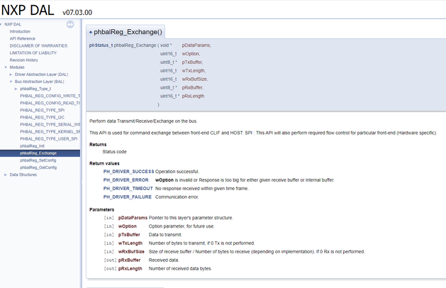

I am trying to run the discovery loop provided by the library to an STM32 controller. As per my understanding in the library and documents provided, the BAL Layer is controller specific and we have to add our controller specific SPI functions
Experts from the community, can anyone in the community please provide a step by step guidance to follow so that i can implement the same on STM32. i have the EVM board with kinetis controller and would need the step by step guide/suggestions to implement changes so that the PN5190 library can be integrated and worked properly with STM32 controller.

I would suggest you refer to the NXP DAL API guider.  it is under the reader library.  Please check BAL for more details.

yes from what i understand is to add stm32 specific spi and other gpio details with bal layer would make the library portable to this controller
One doubt regarding the ph_osal layer - this is controller related and if we are planning to use null os then there are examples for cm3 and cm4 controllers but my controller is cm33 based. will this cause an issue or how can i solve this particular dependency issue.

You can use phOsal_Port_PN76XX.C as a reference.
PN76 is CM33 based.
