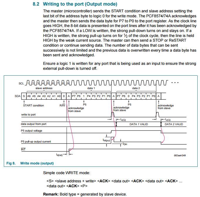

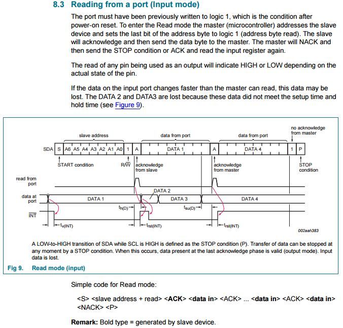

Hi ,
      I am using PCF8574T I/O Expander along with Accelerometer and when i am trying to writing to the PCF8574 my I2C code hanging and also I am little bit confused with PCF8574 Input and output configuration, so please any one suggest or send me sample code for PCF8574 with I2C.
