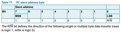

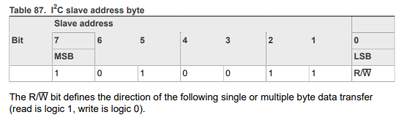

What is the PCF2131 RTC I2C slave address. I couldn't find it in the datasheet.

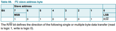

Also can confirm that the PCF2129/PCF2127 slave I2C address is 0xa2?

PCF2131:
The appropriate I2C-bus slave address is 1010011. The entire I 2C-bus slave address byte is shown in Table 87 of the datasheet: https://www.nxp.com/docs/en/data-sheet/PCF2131DS.pdf
PCF2129:
The appropriate I2C-bus slave address is 1010001. The entire I2C-bus slave address byte is shown in Table 77 of the datasheet: https://www.nxp.com/docs/en/data-sheet/PCF2129.pdf
PCF2127:
The appropriate I2C-bus slave address is 1010001. The entire I2C-bus slave address byte is shown in Table 88 of the datasheet: https://www.nxp.com/docs/en/data-sheet/PCF2127.pdf

Considering the LSB, PCF 2131 would have address A6 and PCF2127 and PCF2129 would have address A2.
