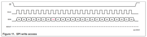

Hi everyone,
I am trying to write to the register and read it back but it didnt give the same value. I would appreciate if someone would look into my code and correct me. I am using arduino Uno
This is the ino file

Please guide me through how to read/write or test the limit switches on the PCAL9714
Best,
Ahmed

ahmedd
Hi David,
sorry for the late response, but I had solved it, here is the corrected code for anyone who needs it

diazmarin09
Hello ahmedd,
As mentioned in another post, I would like to focus on your pcal9714_write and pcal9714_read functions.
The bus master must send the target slave address followed by a read or write operation. The slave address of the PCAL9714 is shown below:
Are you considering such an address before trying to write or read an internal register?
Following the first byte of the slave address, the bus master sends a command byte, which is write-only and stored in the pointer register in the PCAL9714. Finally, the data.
In total, 24 bits of data are transferred before deserting CS.
Could you please share an oscilloscope of your data transfer?
