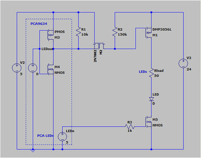

Thanks David so I mean circuit of one channel with FET is
After power cycle LEDx is in High-Z so driver is safely closed by pull-down resistor. I need positive PWM output as I potentially want to use 6-bit PWM at 5.25kHz (fully undimmed).
I there a protection on output in IC ? I use 1k serial resistor just as case or is not needed ? Alternatively more protection with Zener on LED# output?
What I see extra confusing is Table 15. Entries references hi/low transistors to PWM value. But transistors must have complementar values because at least on-on case is short circuit Vdd-Vss.

tma
Hi David,
I have series resistor as LED strip is connected. I have reconsidered component and use PCA9634 which offers 97kHz. I assembled, I can control via I2C, nice! But I see unexpected behaviour, when I connect power then all outputs are 5V so all LEDs are shining. I cannot wait to I2C to switch them off. I have gate resistor to GND so gate should be charged through LED when Hi-Z. Seems 5V come from PCA output. OE is hardwired to GND.
PCAxx has no internal EEPROM to remember default state after power cycle, right? OE=1 won't help, right ? Seems only soulution is add general external switch for 24V.

tma
Hi David, I planned to check OE=1 but seems when I reread PDF more thoroughly that default values always will keep LEDn=5V which is considered as LED off for default case: totem-pole, LED connected +5V->A->K->LEDn.
Default values after power cycle:
OE=1
  • OUTDRV = 1 ... totem-pole output
  • OUTNE=01 -> LEDn=1 when OUTDRV=1
OE=0
  • INVRT = 0
  • OUTDRV = 1
  • LEDOUT = 00
  • Table 16: Driver off -> Upper transistor On, Lower off -> LEDn = Vdd
So I believe I have no chance to simply arrange LED off after power cycle with N-MOSFET driver. Am I right?
Meanwhile I rearranged circuit and use not-used LED7 output to control general 24V hi-side P-MOSFET (with level shifter 5V -> 24V) which is power for all LEDs driven by LED0-6. Default 5V will keep 24V off after power cycle. It should work.
