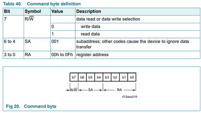

Hello AshBirari,
I hope all is great with you. Thank you for using the NXP communities.
As we know, the first byte transmitted is the command byte. Are you following the correct procedure for the first byte?
Could you please share an oscilloscope trace of your writing procedure?
David

AshBirari
Hello David,
Yes , I am transmitting First byte as Command byte as you can see the above code.
I have tried to upload oscilloscope images but failed . Can you provide mail id where I can attach the results of oscilloscope ?
