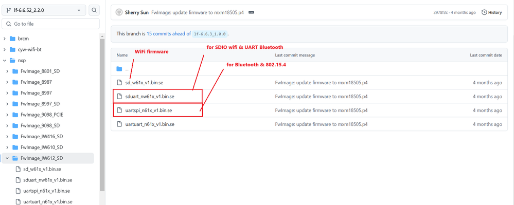

(2) Getting firmware & wifi_mod_para.conf
--firmware
https://github.com/nxp-imx/imx-firmware/tree/lf-6.6.52_2.2.0/nxp/FwImage_IW612_SD
[Note]
--If you want to use WiFi & Bluetooth, Select "sduart_nw61x_v1.bin.se", please!
--If you want to use WiFi, Bluetooth & 802.15.4, Select "sd_w61x_v1.bin.se & uartspi_n61x_v1.bin.se" , please!
--wifi_mod_para.conf
Download it, please! in the file, there exist SDIW612 node, like below, pay attention to fw_name, firmware file's name is fixed here. if you want to use other firmware , here should be changed.
for example, if you want single wifi, and hope to change firmware, sduart_nw61x_v1.bin.se should be changed to "sd_w61x_v1.bin.se ".
