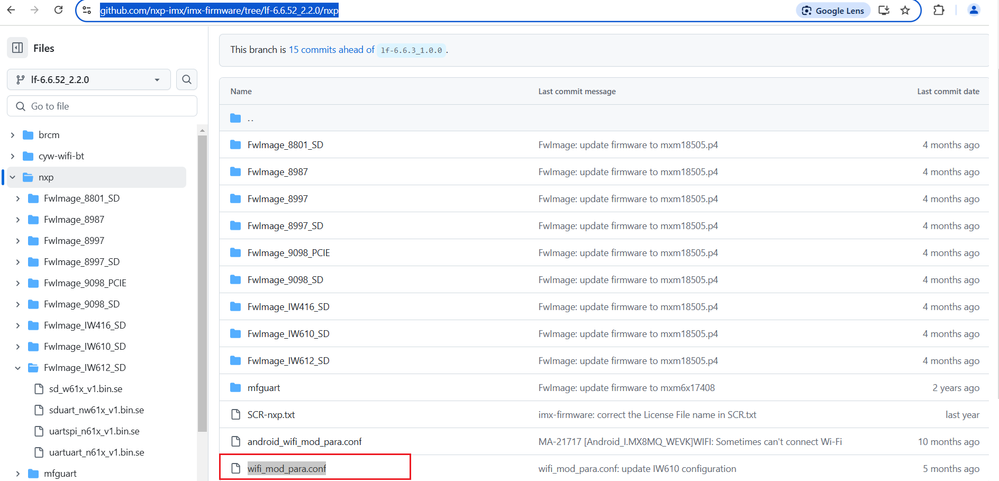

https://github.com/nxp-imx/imx-firmware/tree/lf-6.6.52_2.2.0/nxp
Download it, please! in the file, there exist SDIW612 node, like below, pay attention to fw_name, firmware file's name is fixed here. if you want to use other firmware , here should be changed.
for example, if you want single wifi, and hope to change firmware, sduart_nw61x_v1.bin.se should be changed to "sd_w61x_v1.bin.se ".

(3) Copying firmware & wifi_mod_para.conf to /lib/firmware/nxp on your linux platform of board.
if there is nxp folder on your board, create it, please!  then copy firmware & wifi_mod_para.conf to the folder.
