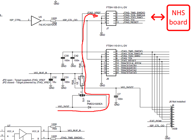

if JP2 is mounted on the LPCLINK2 and the NHS board is connected via the SWD cable (as can be seen in the photograph you attached), the NHS chip is powered from the LPCLINK2 supply via pin 1 of the SWD connector because the battery voltage is typically lower than 3.0V. If the LPCLINK2 is disconnected from USB, the NHS board battery will take over as both battery and LPCLINK supplies are coupled via diodes to VDDBAT.
If JP2 is not mounted, a battery must be used and the LPCLINK2 will use the VDDBAT voltage on pin 1 of the SWD connector to feed its level translating buffers.

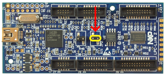

I also notice the JP2 from the figure you sent.
But I do not understand when you mentioned that:
"use LPC-LINK2 with JP set to power the NHS chip via the SWD cable."
I use LPC-Link2 to power the chip. And the LPC-Link2 is link to the chip via a SWD cable (see attached file).
I supposed when the chip is connected to the PC via the LPC-LINK2 and the SWD calble, then the battery is not needed to be charged?
Also, even if the chip is connected to the PC via the LPC-LINK2 and the SWD calble, do I still need to use the JP2?
More precisely, how do I use the JP2?

Correct, if JP2 is set and the LPCLINK2 is connected via SWD, there is no need for a (charged) battery.
In that case, I recommend to remove the battery, this makes it easy to power cycle the NHS by temporary disconnecting the USB cable from the LPCLINK2.

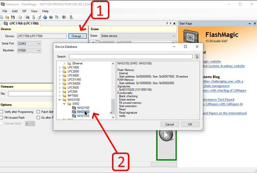

You can use Flash Magic for this:
https://www.flashmagictool.com/download.html&d=13.50/FlashMagic.exe
In Flash Magic: select the correct NHS device from the device database
Select the hex file, check "Verify" and "Go after programming" (otherwise the processor remains halted)
Press "Start" to flash.

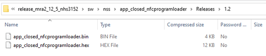

For testing purposes the NFC program loading firmware can be restored by flashing "app_closed_nfcprogramloader.hex" from the SDK package via the SWD cable.

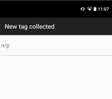

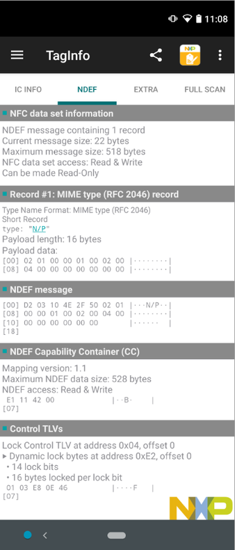

When nfcprogramloader is running, it writes a short NDEF message in the NFC memory which shows a  "n/p" text message when tapped. See screenshot below.
Can you check if this message is present? If not, you need to restore the nfcprogramloader via SWD.
A handy tool to see what is in the NFC memory is the NXP TagInfo app.
