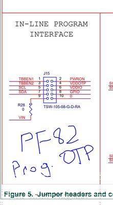

Hello
I will use MFS5600AMBA0ES and MC33PF8200DEES in a project. MC33PF8200DEES has an in-line program interface as shown below. But I have not come across such an interface for MFS5600AMBA0ES. Which pins should I use to program MFS5600AMBA0ES permanently?

This document is under NDA, do you have access to Secure Files?
Please go to Automotive Dual Buck Regulator and Controller with Voltage Monitors and Watchdog Timer FS5600, sign in, go to Documentation and click on Secure Files.
If you have access you will find the application note there, if not, please request access.
2,710件の閲覧回数
ErikaC
Please refer to application note AN13263 OTP programming instructions for FS5600.
