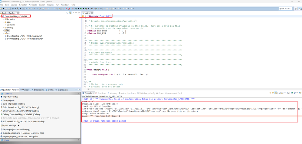

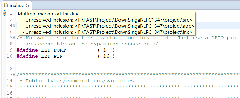

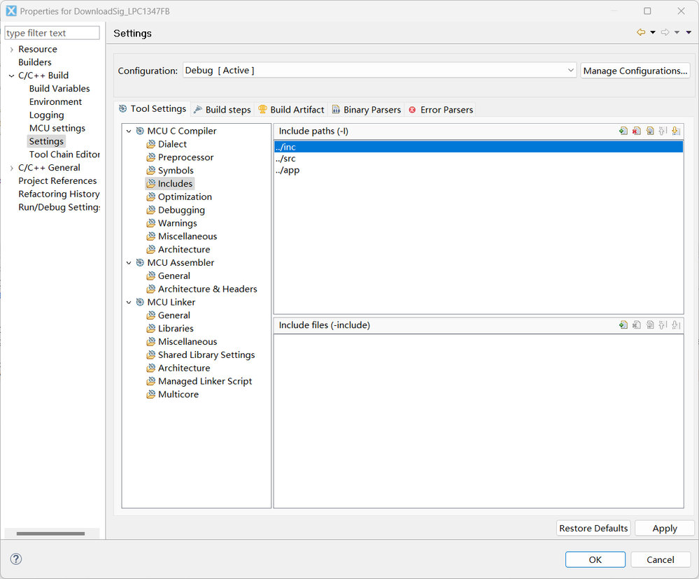

LPCxpresso cannot be compiled, and the path is abnormal.I've set the relevant file path in the properties and put the file in the path folder correctly, but I still get an error.image.pngimage.pngimage.png

It seems you linked the source files to the project rather than copied the source files to the project folder. Can you make sure that the related source files are located in the coresponding project folders?
