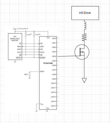

It seems MC33816, PT2001, and PT2000 would be over kill for our application. I really like PCA9635 and PCA9745B.
Can I drive LS MOSFET a attached herewith? I am concerned about whether all LED channels are sinking pins.
551 Views
labib_leggett
We wan to drive solenoid like this, it it possible to drive like this
530 Views
JozefKozon
Hi Labib,
yes, it should work. There is an example in the PCA9685 datasheet, in the page 29. using external MOSFET to drive LEDs, with required bit settings. I guess you can also use it to drive solenoid.
