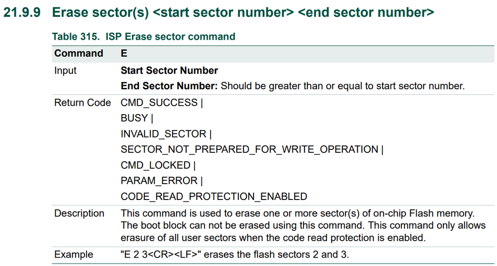

When checked in user manual,
First the code read protection need to be disabled and then using ISP Erase sector command, flash memory could be erased. Please confirm the approach is valid and also request to provide sample code for it.

Hi Sudhakar, I hope you're doing well!
The "Erase Sector" ISP command can be used to erase specific sectors of the Flash memory of LPC2294:
Keep in mind that the boot block sector cannot be erased using this command.
With code read protection disabled, the user needs to send an ISP Unlock command to enable the use of the Write, Erase and Go commands. Then, they should be able to use the Erase sector command.
For more information, could you please take a look at chapters 21.8 and 21.9 of UM10114?
Please let me know if you need any more information.

Sebastian_Del_Rio
Hi Sudhakar,
I'm really sorry for the inconvenience this may cause, but unfortunately, that's currently all of the information we have available to share for this MCU regarding the use of ISP mode to erase all of the contents of the flash.
Unfortunately, there's no example code for this specific functionality available at the moment for the LPC2xxx series.
