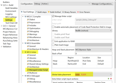

Please follow below to set global data placement in USB_RAM. thus the .bss and .data sections will be placed in USB_RAM
Have a nice day,
Jun Zhang
