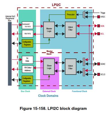

shrithi
Hi Chavira,
I used the kernel to read and write i2c. I am facing an issue where the first I2C write will pass and the second I2C write will fail.  Can you provide an I2C master flow diagram?
Shrithi
5,641 Views
Chavira
Hi @shrithi!
You can find a detailed flow described in Reference Manual on the chapter "5.8.2.2 Master Mode".
You can find a detailed description of the driver in our Linux Reference Manual on chapter "4.6 Inter-IC (I2C)".
https://www.nxp.com/docs/en/reference-manual/IMX_REFERENCE_MANUAL.pdf
Best Regards!

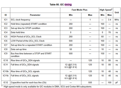

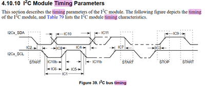

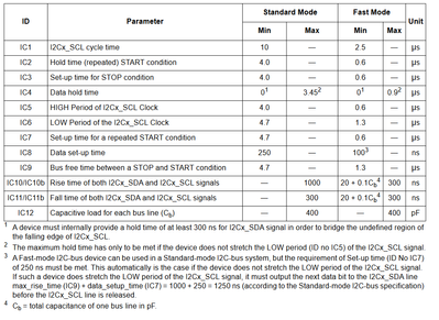

Hi Chavira,
Can you give i2c write and read timing diagram?
Shrithi
5,588 Views
Chavira
Hi @shrithi!
You can find the table in datasheet.
Best Regards!
