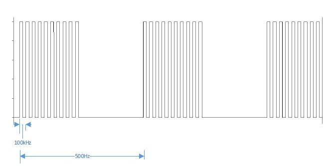

ranjithshanbhag
Hi Kerry,
Thanks for sharing the code. It is really help full for us to proceed further.
We need to produce frequency modulation like mentioned earlier, Carrier frequency is 500Hz and Modulated frequency is
100KHz.(Please find the below picture). Is it possible to generate internally? so we will have modulated output in single PWM pin.
Both the Dutycycle shall be varied during run time.
3,651 Views
kerryzhou
Hi Ranjith Shanbhag,
    You can consider to use 500HZ PWM function as the timer, not PWM output.
   The timer is 1Khz, or others, it determined by your duty design.
    When the according match happens, you enable the 100Khz output. when the next match happens, you disable the 100Khz, then you will this the wave you post in one pin.
  Please try to modify it by yourself.
    Normally, for the new question, you need to post the new case.
Wish it helps you!
Kerry
3,651 Views

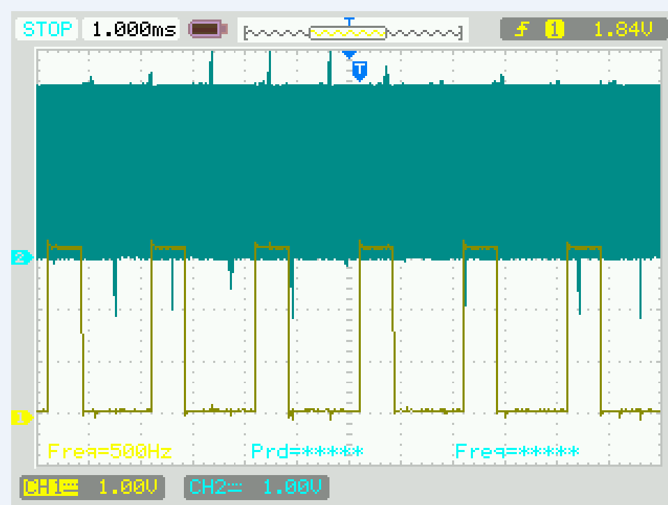

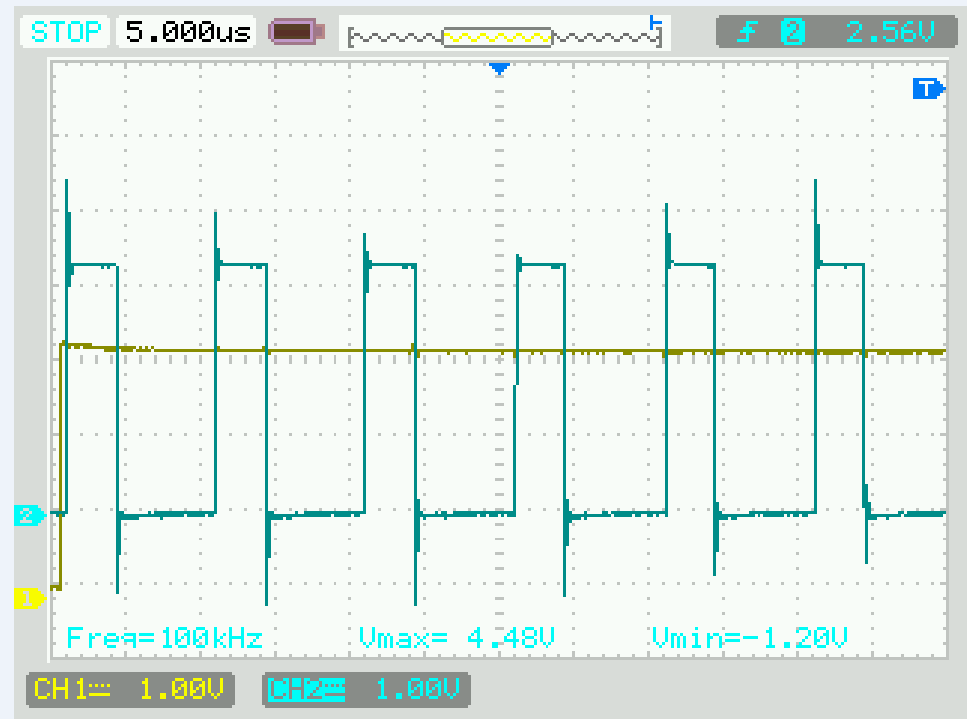

kerryzhou
   Please use my attached project.
  This project will generate 500hz at PIO0_16, 100khz PWM at PIO0_12.
This is the test wave in the LPCXpresso LPC824 max board.
Wish it helps you!
If you still have question, please let me know!
Kerry
