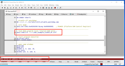

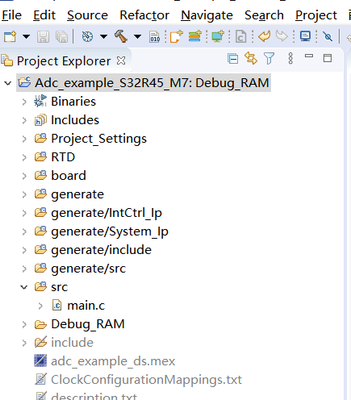

First:File -> New -> S32DS Project From Example" and select one R45 example.

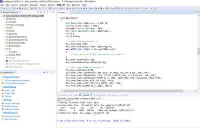

then,I Select the "S32 Configuration Tool" menu then click on the desired configuration tool (Pins, Cocks, Peripherals etc...). Clicking on any one of those will generate all the components. Make the desired changes(if any) then click on the "S32 Configuration Tool->Update Code" button.
build no errors。it generate *.elf binary file。
I use LaterBach Debug the project,when I load the elf file,it occur an error“bus error at address EST:0x34500000 -- 0x34503BFF”
From your description it looks like you are not using proper programming script for Lauterbach.
Check the flash.list /flash definition range of your script if there are all the flash block defined in reference manual and available for programming.
