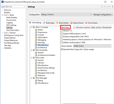

I want to know how to add -ftrapv to compiler option for MCUXpresso.
https://www.keil.com/support/man/docs/armclang_ref/armclang_ref_sam1465488663864.htm
Please teach me.
Ken
1 回复
1,072 次查看
danielchen
-ftrapv is an option for GCC code generation conventions.
I would suggest you add it in 'MCU C Compiler'
