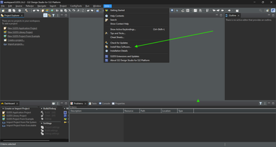

I am getting below error while opening GrayVIP.mex from
https://nxp.flexnetoperations.com/control/frse/download?element=7580181
PlatformSDK_S32N version is not supported by current version of tool
Please see the pics attached.

Hello @SumantGupta,
Sorry for the late reply. You will need to install https://nxp.flexnetoperations.com/control/frse/download?element=7557921 and https://nxp.flexnetoperations.com/control/frse/download?element=7570161, in particular
SW32N5_S32DS_3.6.3_EAR_D2507.zip and SW32N_RTD_R21-11_1.8.0_CD05_D2507_DesignStudio_updatesite_updated_D250805.zip, you will need to follow these steps for both of them:
After installing both of those packages you should be able to open the mex file in S32N projects in the GreyVIP.
Please let me know if you are able to solve your problem
