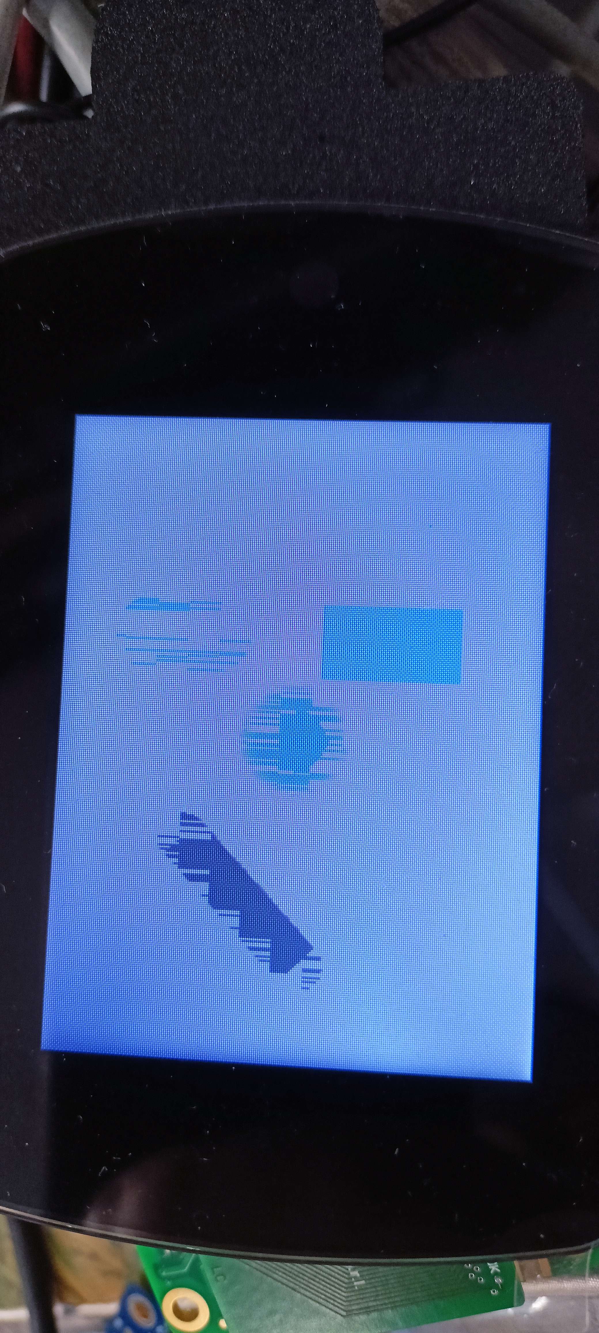

I am developing an application based on the MiMX1052RT processor, embedded on a custom board and a custom color LCD display 320x240. I use MCU-Expresso with GuiGuider 1.7.0.-GA and LVGL version 8.3.10. All the toolchain works fine, but I have an issue in visualizing widget with rounded shapes on the display: all the boarders are stable and OK, while the internal colors appears to be scrached (see pictures enclosed).
I am pretty sure all the hardware settings to the display are OK (16bit RGB, double frame buffer scheme, 52Hz refresh rate) since:
- I send only one frame to the display, and
- all the syncronization signals are present and clean, with the correct frame rate
- the image remains stable
- the colors are fine
But the image is corrupted in the fillings.
I believe that there is something odd with the blending between the image and the alpha channel, since if I modify slightly the opacity setting (from 100% to 98%) the image get sharply worst (see pictures). Another thing to note is that also images (not shown in the example enclosed) are affected by this if I set the attribute True Color Alpha on GuiGuider, while they are perfect if I set True Color only.
I have tried a lot of things, but nothing worked.
Any idea?
Thank you
22/02/24 - UPDATE
I discovered that if I put on top a transparent image all the background widgets are drawn correctly. This supports the theory that there is something odd with the opacity. See "Image Custom Display - top transparency.jpg".
Please give me an help becouse I don't want to put this additional layer, it complicates me all the touch user interface features....

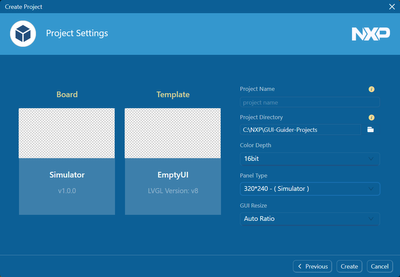

EdwinHz
Hi @Amoro,
From what you mentioned, I understand that you selected "Simulator" when choosing a board template on the project creating window, and then you selected the appropriate display resolution, as follows:EdwinHz_2-1709235524123.pngEdwinHz_2-1709235524123.png
Is this correct? Even though you are not using the actual RT1050-EVK, creating a project with this board as template allows the project to be created with all of the data and drivers required for the RT1050 MCU specifically. So, instead of selecting a simulator project with a simulator display type, I recommend you to select an RT1050-EVK and add the custom display as follows:
Note that the Display Panel Type box is text based, so you can manually type the display type that you are using. I wrote LCD as an example.
BR,
Edwin.
