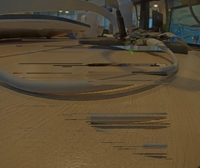

I'm using csi_mipi_rgb_cm7 example. I customized the example for my camera, so I'm not using ov5640. With `DEMO_CAMERA_BUFFER_COUNT 2` I can get solid 20~fps with no image tearing or anything on my LVDS. But when I increased DEMO_CAMERA_BUFFER_COUNT to 3, I get full 30 fps which my camera supports, however the image see on my LVDS is like the one I attached.
- I get this image by memory dumping the &cameraReceivedFrameAddr, so it cannot be LVDS issue.
- And also when I increase Cortex M7 Core Root Clock higher, for example 600 MHz, more of this tearing thing happens.
(Note project runs on BOARD_SDRAM)
What may be the issue ?
Thanks in advance.
12,684 Views
kerryzhou
Hi @kayakaantuna ,
   After internal checking, still in the SDRAM read area have limit, you can consider it is the hardware limit.
  As the semc just can connect 16bit max data length, then even your code use the 32bit read, still have read limit.
  I am thinking, your LCD resolution is smaller than the camera, why you don't change your camera solution to the same to the LCD, that may save some frame buffer.
  Normally to the SDRAM read limit, just can use the low FPS to resolve the issues, no other workaround now.

10,208 Views
kerryzhou
Hi @kayakaantuna ,
   Thank you for your interest in the NXP MIMXRT product, I would like to provide service for you.
   Please tell me which board you are using? MIMXRT1170-EVK?
   Do you mean, you meet the issues like this:
  This phenomenon is normally caused by the CPU load being high, and the refresh speed can't reach up to 30 fps. Do you enable cache or not?
Kerry

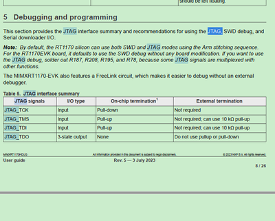

Also I wanted to look CPU usage using JTAG, but the related documentation about the topic was only using SWD.
Is there any way to check CPU usage using JTAG ?
Thank you so much!
10,198 Views
kerryzhou
Hi @kayakaantuna ,
  Thanks for your updated information.
  RT117x can support the JTAG directly, in your debugger connection interface, you can select the JTAG interface, it's OK to use.
kerry
10,196 Views
kayakaantuna
Hi @kerryzhou,
No I meant I can't see the CPU usage using JTAG, and I couldn't find any documentation related to the topic.
10,190 Views
kerryzhou
Hi @kayakaantuna ,
   JTAG information, you can find it from this linker:
https://www.nxp.com/webapp/Download?colCode=MIMXRT1170HDUG&location=null
Do you meet the JTAG connection issues?
In fact, to debug the code, SWD also the same.
If you need to use JTAG, you can use it, but you need to make sure all the related JTAG pins connect to your debugger.
Kerry

10,177 Views
kerryzhou
Hi @kayakaantuna ,
  To the tearing/glithing issue on camera image. maybe still need to use 2 framebuffer.
kerry

kerryzhou
Hi @kayakaantuna ,
   After internal discussion, seems your situation is related to the SDRAM bandwidth, normally, this situation will no other improvement methods.
   Do you try 25fps, whether that is stable or not?
  BTW, do you use the PXP to switch your CSI from 1280*960 to the LCD resolution 1280*720?
  What's the SDRAM data width you are using? 32bit in your hardware?
Kerry
