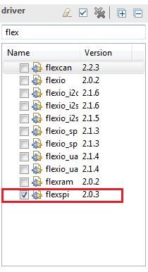

anupbhutada4
In attached image, I am not getting Flexspi2 driver. I am using SDK_2.x_EVK-MIMXRT1064(Ver 2.4.1). So please tell me if  I am missing anything. Thanks In Advance.
3,860 Views
fangfang
Hello
FLEXSPI2 is used to connect the internal qspi flash, so you can't find the according pins.and so there is not the driver for it.

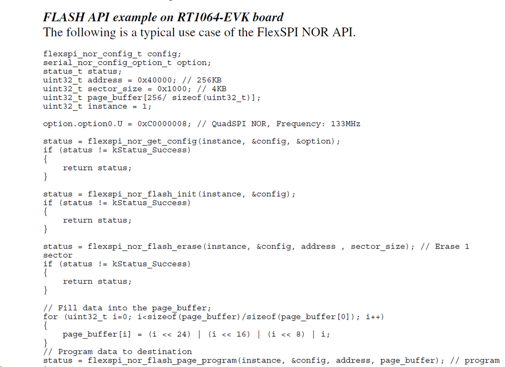

anupbhutada4
Thanks for your quick response.
We need to partition the internal flash in two sections (2MB each). One
section will have the running application image. This image will have code
to write different image (firmware update) to other section. Is there any
API to store the data at any address of internal flash. In ProcessorExpert
(MK22FN1M0), the component “IntFLASH” is available for accessing internal
flash using methods such
as __EraseFlash(),_SetByteFlash(), _SetWordFlash(),
SetLongFlash(), IntFlashLdd1EraseBlock(),
IntFlashLdd1_Write(),IntFlashLdd1_Erase().
Is there any similar kind of APIs available for accessing internal flash of
I.MXRT1064?

fangfang
You are welcome. Please find the FLASH API example as the reference manual (P268).Hope it help you.
